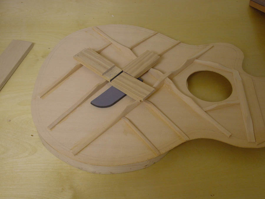

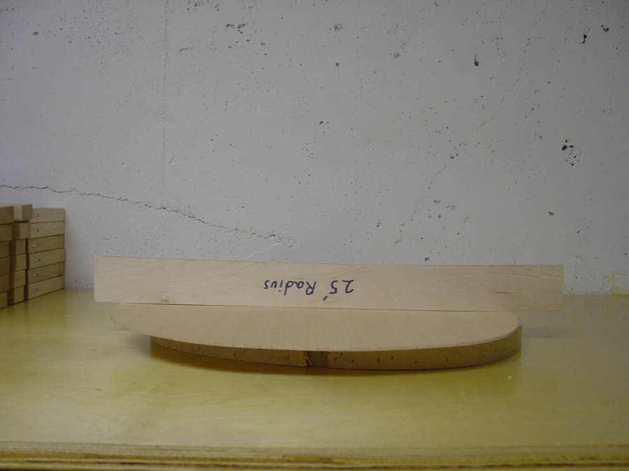

Pic #1- Top with a 25' radius gage.

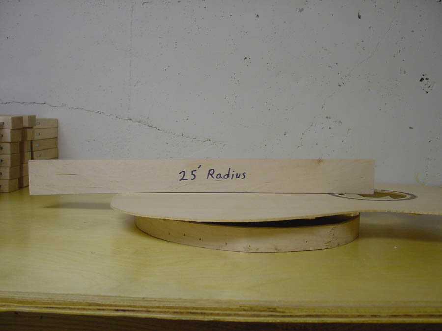

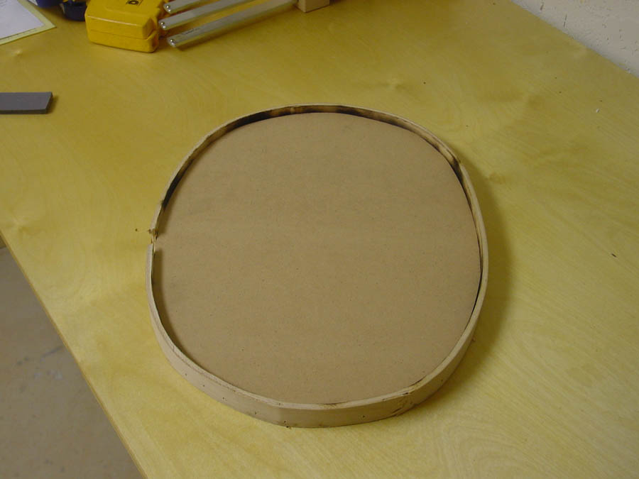

Pic #2 - The jig I made, that allowed pressure to be placed at the edges of the top, and
approximately the waist area. The total possible deflection is a little more than a .25"
which I believe is a little more than what you would have, considering the width of the top,
at the original 25' radius.

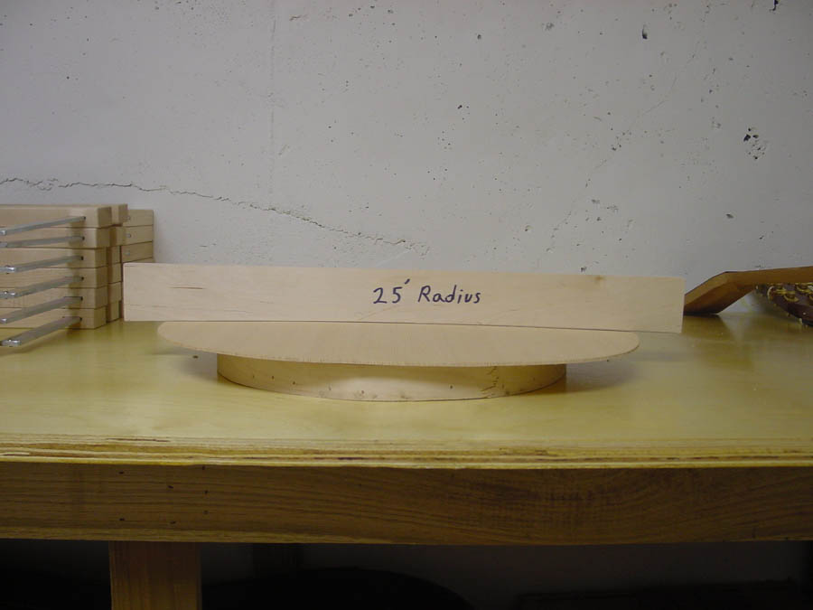

Pic #3 - Blocks, strategically placed.

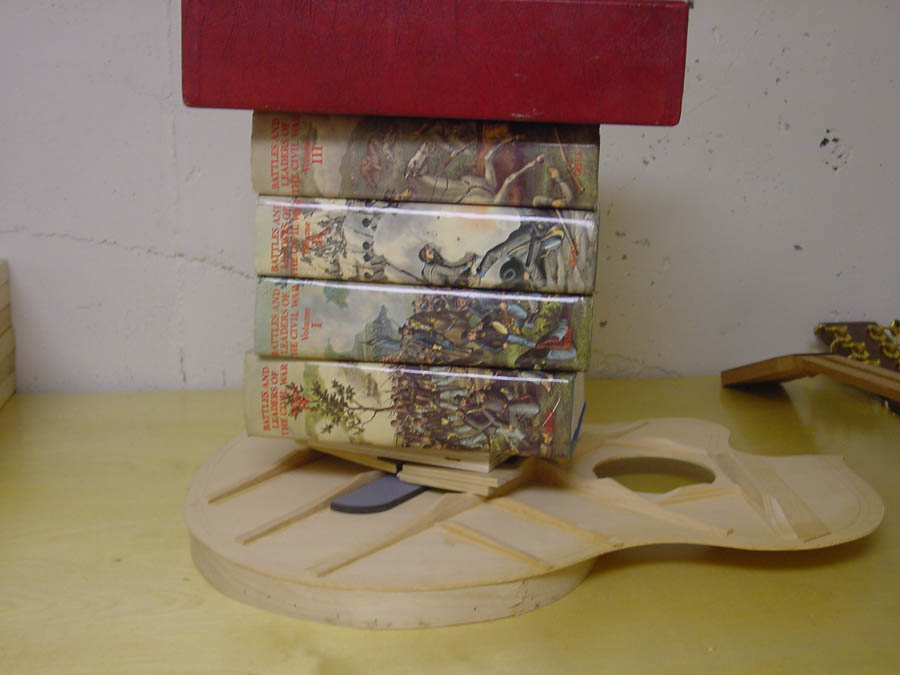

Pic #4 - The weights applied.

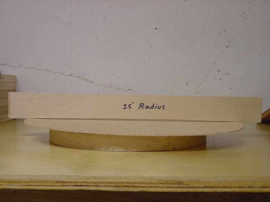

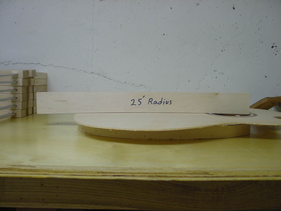

Pic #5 & #6 - initial results after a few days under pressure. At this point, I thought for sure I had
achieved complete success, however, after a couple of days, it returned to its concaved position.
So, back on the weights did go! This time I left them on for a week.
Pic #7 & #8 - these pics were taken after a week of sitting around in the shop with no weights.
I’ve almost got the full 25' radius back, in relation to top and bottom. However, it didn’t get any
better than flat, in relation from side to side. (The opposite side of the gage is straight). This time
I think they’re gonna hold.

Hesh, thank you my friend! As far as, civil war history goes, I know about as much, as what I
see on the history channel. Those books belonged to my late grandfather, who really was a “civil
war history buff”. He had a small library, which I inherited. It just so happened that they were
the heaviest things I could find at the moment. Maybe one day I’ll get around to reading some of
them. For now though, they make really good weights!
